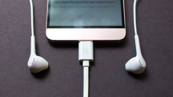

But USB audio is different. In this case, the SoC sends the digital data straight out through the USB port (Lightning, microUSB, Type-C, what have you) and there is zero processing done on the device side. Of course, since neither your headphones (nor you) can process the digital signal, it has to be converted to analog at some point. This is why every device connected to the USB port for audio purposes has to have its own DAC/ADC built-in. It processes the digital signal, which otherwise would have to be done on the phone and then sends it to the amp, which also has to reside on the USB device, so it can power the speakers. These parts take power from phone port itself.
If you take the example of a USB Type-C headphone pair, such as the ones LeEco now sells with its new phones, the DAC/ADC and the amp are actually placed somewhere within the cable, usually near the USB port itself. On some headphones, it could be placed within the microphone module, or sometimes within the driver units. This is not a new practice and this is how Bluetooth headphones have always operated, as they too receive pure digital signal from the device and then have to process it. They even have the burden of dealing with the wireless signal and have extra circuitry for that.

USB audio
I find it amusing that we see digital audio output from our phones as the future. If you look back a decade or so, the phones then all had digital connectors and the standard headphone jack was nowhere to be seen. Remember the Nokia Pop-Port? Or the Sony Ericsson FastPort? Good times.
But that didn't work now, did it? A few years later, we all ended up coming back to the gold standard that was the TRS jack. Even Apple when it launched the iPhone chose to go with a standard (albeit unnecessarily recessed) 3.5mm jack, even though it would have made way more sense back then to just send audio through the 30-pin connector as some companies were still doing it.
So then why now? I think there is a lot of buzz these days around the whole high resolution audio thing. Manufacturers claiming they can use the pure digital output of their phones' USB ports to send you uncompressed high quality sound. But this is nonsense.
As I mentioned before, your ears are not compatible with digital audio. Whether it's 16-bit or 32-bit, MP3 or FLAC, your ears won't be able to hear it. We can only listen to the analog audio after it has been properly amplified. And whether the processing is done on the phone or within your headphones is moot.
You could have high quality 24-bit track on your phone. It could get processed first within the phone and then sent over an analog connector to your headphones. Or it could get sent directly as a digital signal to your headphones and then converted to analog and to your ears. At which point during the chain the conversion happens is irrelevant. So saying USB audio is better because it sends pure digital audio is marketing nonsense as at some point it does get converted to analog and the end result is the same.
Also, having the audio processed on your phone in most cases would be preferable. The audio codec used on your phone could be of significantly better quality than the one on your headphones. Even relatively cheaper phones could have a pretty decent Qualcomm codec whereas a cheap pair of USB headphones is likely to skimp out on the quality of the onboard DAC and amp, thereby directly affecting the sound that you hear.
We are also adding to the cost of the headphones themselves. Phones aren't going to be cheaper because they now have one jack less but the headphones surely will be more expensive regardless of how they sound simply because of the added engineering the cost of materials that will go into making them. Why do you think Bluetooth headphones are still so expensive compared to their cheaper and better sounding wired counterparts?
If you don't want to purchase USB headphones, you will have the option to use an adapter. So now this $5 accessory is entirely responsible for the kind of sound you hear, as it will be in charge of processing it. You can imagine how well that will go.
Here's where it gets annoying though. What if you want to charge the phone while listening to music? Also, imagine in future you have an Android phone, an iPad and a laptop. You will now need three different headphones, or at least two different adapters. Good luck with that.
It's easy to dismiss some of these as teething issues and something that will get better with time. But as I mentioned before, it didn't get better with time the last time we had digital audio connectors and we had to fall back on the good ol' TRS jack. That is unlikely to happen now, though, which means several years of unnecessary suffering with multiple adapters, cables and what not. And in the end if this was all going to be worth it, it would still be fine. But we have seen that it's not and nobody has really offered a compelling reason to switch to USB audio yet.
The funny part is, we have had USB audio for a long time now. The iOS devices already output audio through Lightning connector. Android phones running Lollipop and above can output USB audio. Even older Android phones with a custom configuration could output audio through microUSB. We have had a so-called superior audio interface at our disposal for a few years now, and yet no one switched to it. We hardly have any earphones or headphones that connect directly to them. We don't because no one cares. Not even audiophiles as the advantages are just not worth it, because there are barely any.
And yet we will soon be forced to switch to the digital interface completely. As an audio and technology enthusiast, I look forward to playing with them. But as a consumer I find it baffling that companies are willing to take the choice away from you of using your existing headphones just to save some space inside so your next phone could be even more unnecessarily thin, or worse, just to one-up each other.

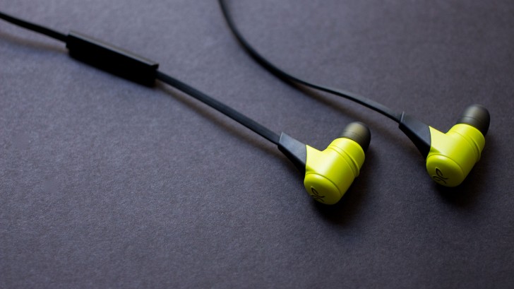

Wireless audio
Among all this kerfuffle we might finally see the rise of wireless headphones as the preferred choice among customers. Like I said before, there is no stopping the 'no-headphone-jack' train at this point. But you can always choose to use wireless headphones over USB audio.
The advantages this offer are actually tremendous. For one: no wire. It's just one of those things that you need to experience for some time to truly appreciate it. You think you can live with cables but once you use a pair of good quality Bluetooth headphones, the complete lack of cables is incredibly liberating and you never want to go back to cables.
They also work with pretty much everything now. Your phone or tablet, regardless of brand, your laptop, maybe even your MP3 player already supports Bluetooth. It's actually far more universal than you think, second only to the standard TRS jack.
As for the audio quality, I know it has been the reason most people avoid Bluetooth headphones, yet every pair that I have listened to in the past few years sounded absolutely great and they seem to still be getting better. With lossless codecs like aptX and LDAC you don't even have to worry about data loss anymore. And did I mention they are wireless?
All in all, to me this seems like the way to go in future, and I have a feeling companies will be pushing for this too (I bet there is going to be a major push for Beats wireless headphones from Apple following iPhone 7 launch). No, it probably won't sound as good as your audiophile set of wired headphones, but I'd rather live with good sound instead of great sound and not deal with the hassle of multiple cables and adapters. And I swear I mentioned they are wireless. I cannot stress the importance of that enough. I mean, it's 2016. We have wireless chargers now but we are still arguing which cable is better for transferring audio instead of using the free air around us.
